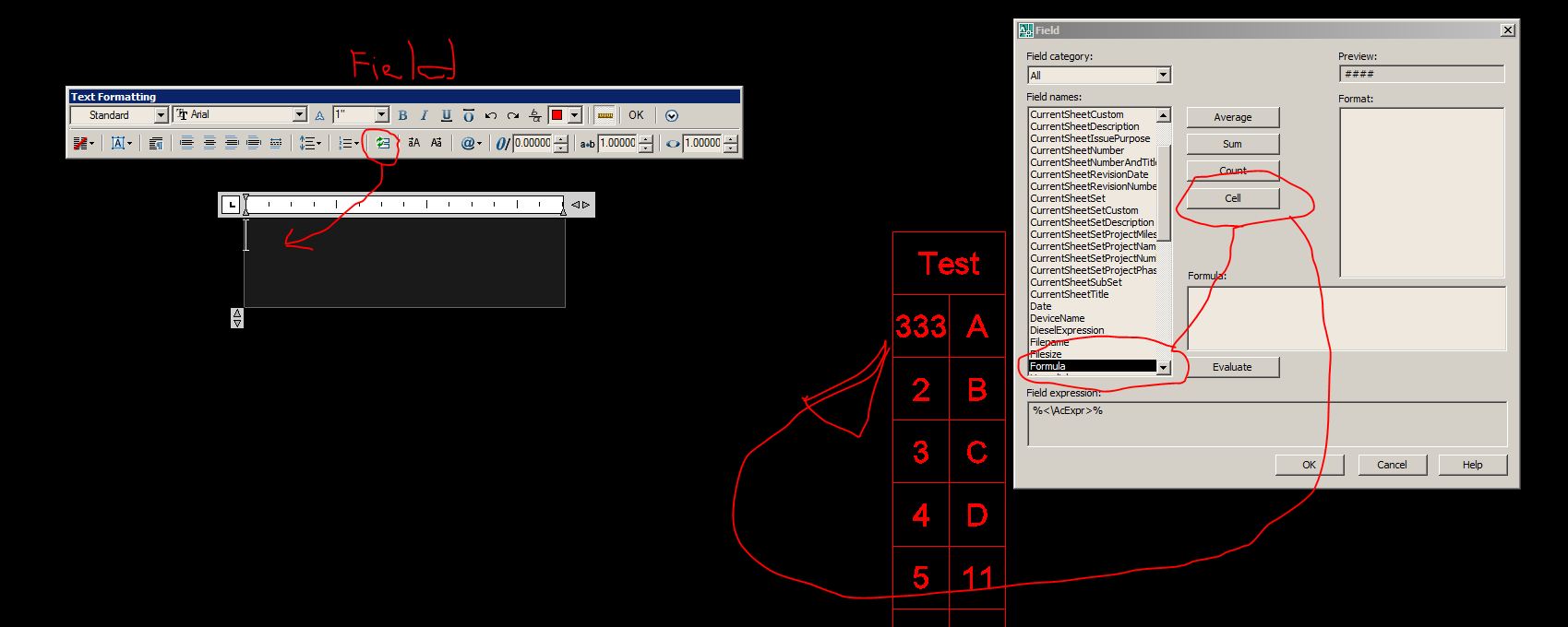

I think you can use Mtext and extract a cell in a Table, when you change the cell content it will update your text.
My bad, it only works with Numbers, not Text.

Patchy
I thought it works until I used text instead of number 😣

Patchy
The table is only used for holding the numbers, try this see if it can help your need.

Patchy
Probably my .dwg is an old format.
After made your Table and have the numbers in the cells,
Use MTEXT type in your text and when you want to reference the number, click in FIELD, use this setting (see photo)
 Then double clicks in the Table cell to insert the number.
