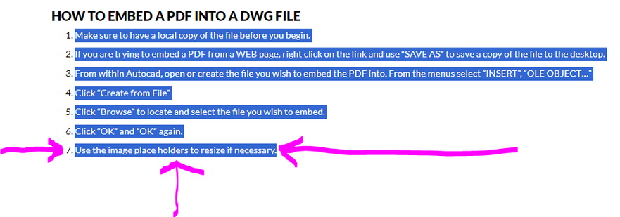

What is the best way to embed a PDF into an AutoCAD drawing, in model space? I want it embedded, so when someone clicks on the image, the PDF opens regardless whether they have access to our filing system or not. I have tried to use ‘OLE Object’ but when I reopen the drawing, the ‘OLE Object’ has disappeared, and it wants to run the recover command to fix errors. I have looked around the internet and this seems to be a common problem, but I can’t find any fixes. Image attached.

@paul_braithwaiteCKX8G wrote:
... I have looked around the internet and this seems to be a common problem, but I can’t find any fixes. Image attached.
This tutorial works great unless you missed of skipped a step, and OLEs can be horrible in appearance (all depends on the quality of the PDF content) and do often require rescaling. Achieving a perfect scale is to say the least a challenge, but it is what you want to deliver so here it is
Anticipate that your recipient may object to the quality of the image if that is something they care about more than their fear of PDF as attachments.
...I have tried that and it’s still not working for me. The internet is full of other people with the same problem....
Never been an issue here, we do it all the time or coversheets and manufacturer spec-content we need to quickly include on sheets. There must be a step getting missed perhaps? I can't tell from here.
You can also just copy/paste, you have to use the capture tool from inside your PDF viewer though, nothing else.
