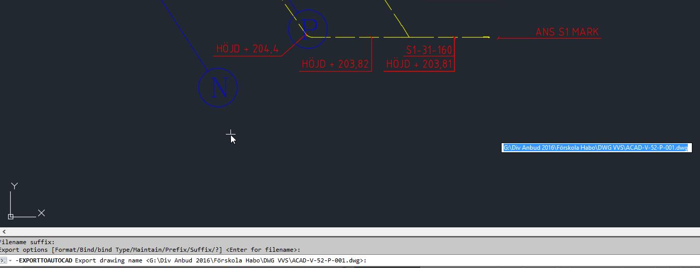

Why can not I delete or edit the text.
The file is from Magicad.
Pas
2,574 Views
Patchy
to get rid of Proxy to have to use EXPORTTOAUTOCAD command.
per_anders
Pas
Patchy
Make any name and that will be your new stripped of proxy objects drawing.
https://knowledge.autodesk.com/support/autocad/learn-explore/caas/CloudHelp/cloudhelp/2016/ENU/AutoC...
or you can DXFOUT your drawing to earlier version then DXFIN.
per_anders
Thanks for the help, it works now.
