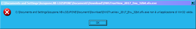

The dowload of this free package from
http://www.autodesk.it/products/dwg/viewers
gives the option for a 32bit or 64 bit download
I use Win XP sp3, thus I downloaded the 32bit version, but when executing I achieved the message that, translated from Italian, says that the .. exe is not a valid Win32 application
not valid.tif
Any suggestion ?
Thanks a lot

Hi @Anonymous,
The issue could be with the Windows operating system, as Windows XP is no longer supported by DWG TrueView, as per the system requirements

If so, why to ask on the site to chose if download either a 32bit or a
64bit version ?
Is it possible to access older versions ?
