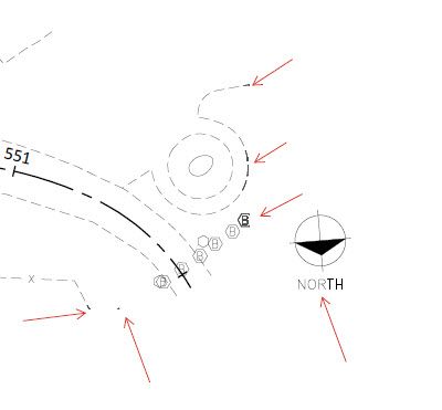

jnelson1071
We also just noticed this same issue.  This happens to us with the objects on the same layer even.  We are using CTB and not STB.  I confirmed the plot settings between the versions, and everything matches.  We also tested using out of the box Grayscale.ctb, tested using the default profile, and used the DWG to PDF.pc3 from each version's ENU location to rule our customization or our shared "DWG to PDF".  This appears to be random issue across the sheet, but if you zoom way in on the PDF, the line weights seem to match.  I also had them plot to paper, and same thickness changes.  It doesn't matter who on the team plots it, we get the same results.  Here is quick example
