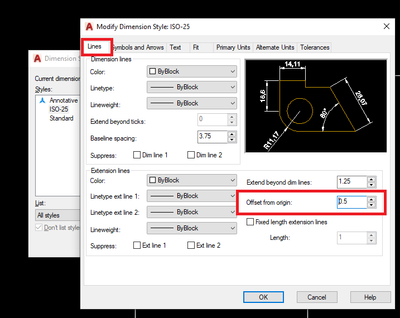

I would like to know if there is  fast way that I can pull a dim and it will come out .5 from the two endpoints?

QDIM or Dimlinear commands with proper dimension style settings. I mean you have to modify the extension lines   Offset from origin value from your current dimension style.

imadHabash
@lee.pellegrin
Click on below image to enlarge...
Imad Habash

QDIM command after you edit the DIMSTYLE: comes in handy if you preset your templates and custom dimstyles to do that in the first place.
You have to put the work in first in AutoCAD.
