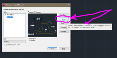

@michaelrichards3 wrote:
A little context , I'm a student and my book is telling me to create these dimstyles using the new dimension feature. I sadly only have Autocad2025 and have no other variants of the program.
If your book does not provide you with images, this is how yo create a new dimensions style in AutOCAD2025
