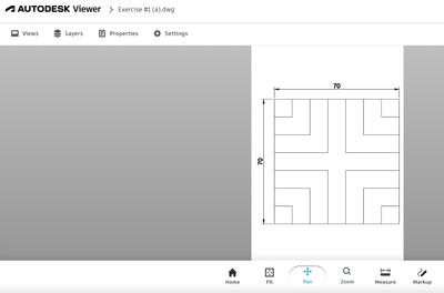

imadHabash
Solución aceptada
As you can see in below image .. every thing is OK!! I have do nothing,i've just open the drawing.
How about the solution in message 3 above?
Imad Habash

Valentin-WSP
Solución aceptada
@451205861 ,
Must be a language issue, since opening in Autodesk Viewer seems good.
Does the laptop use any other language other than English? If so, it may be the issue.
After changing the language, close and restart AutoCAD.
Please select the "Accept as Solution" button if my post solves your issue or answers your question.
