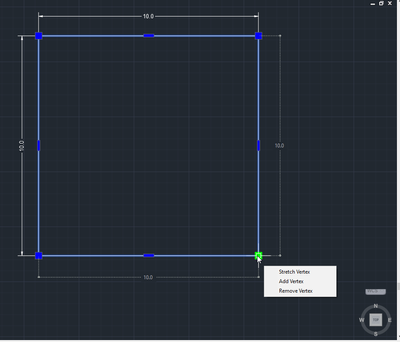

3li_abufahad
I was working normally on the program and there was no problem, but suddenly this happened
Dimension numbers appear reversed. When I type, for example, the number 207, the number changes to 702

This is what your posted file looks like over here @3li_abufahad Not sure I see your issue, or is this meant to be 0.01?

3li_abufahad
I mean, when I have a square with a dimension of 10 cm by 10 cm, and I set the dimensions for it, the dimensions are reversed, so it says 01 cm by 01 CM, a second example is if the dimensions were 95 by 95, the program writes the dimensions 59 by 59
0 Me gusta
3li_abufahad
This is what happens to me
Thank you for the video: unfortunately the DWG file and it's dimensions that you shared here does not do that.
PLUS the DWG file you shared has it's DWGUNITS set to INCHES, not cm..
And you also have UNITS are set to METERS (aka 10x CM, so 10cm is 01m, isn't that correct).
You lost track of the units settings in your file. Nothing more: start reading all about that here
