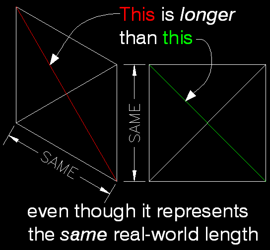

That may be the case if you tilt the world about only one axis [you're picturing the X or Y axis, I imagine].  But not when it's tilted isometrically, which involves all three axes, and that matters.  Think of a square drawn in isometric projection, like the one in the OP's original image around the larger Ellipse, and in this image:
You can dimension that square along its edges, and they'll represent the "real-world" size of the square, because they're parallel to the isometric axes.  But the diagonal from upper left to lower right is longer than the diagonal of such a square when viewed head-on, and the other diagonal shorter, and you can't dimension along those and get "real" results, because they're not parallel to the isometric axes.  Same for the major and minor axes of an Ellipse, compared to the circle of which it is a projection -- they get stretched exactly as the diagonals in that square do, one stretched longer and the other shorter than the "reality" they represent.

GrantsPirate
You are using the term 'Isometric Projection' when you mean 'Isometric Drawing'.  Two very different things with different results.  Iso Projection actually takes into account the tilting of the various axis when it is projected (hence the reduction in size of about 2/3 when projected) where an Iso Drawing is 'faked' by drawing real lengths along the isometric axis.

Kent1Cooper
Not according to this.  See the "Some 3D shapes..." image on the right, where on the cube, the black dimensions along the axis directions of the object represented are equal to the red dimensions of the 2D projection drawing of it, the same as in my images.  In any case, despite any question of terminology, what the OP is doing is clearly what you are calling an 'Isometric Drawing,' in which case what I said holds true.
