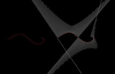

@SEANT61   Thank you for your response.  Using your formula for curvature I modified the DOCL program to draw lines that represent the magnitude and location of the radius of curvature along a spline.  The program works for 2D and 3D splines.   The cross product of the first derivative and second derivative vectors is used to create a unit vector (perp)  perpendicular to the tangent vector (der1).  The program also prints the magnitude of the curvature for each of the 100 evaluation points.
I think the results look very good!  Thank you for your help.
Some examples.
As expected, the curvature lines for a spline arc are all the same length and perpendicular to the spline tangents.
The inflection point of the spline is clear in this example.
In the following example there is a discontinuity of the first and second derivatives (sharp corner) as a result of having 3 coincident CVs.

Message 18 of 22
Kent1Cooper
That looks like a reversal of what's intended -- the Lines are shorter in areas of tighter curvature, rather than longer.  They should be approaching zero length near places of inflection [change in direction of curvature], rather than getting extremely long there.
Kent Cooper, AIA
Message 19 of 22
leeminardi
I just noticed an error in my last program posting. I do not have time right now to fix it but will do so soon and give the user the option of showing curvature or radius-of-curvature.
lee.minardi
Message 20 of 22
leeminardi
I have modified the program to let the user chose whether to create a radius-of-curvature vector image or a curvature image. The ends of the lines in the radius of curvature image are the instantaneous center of curvature for the spline at the point where the other end of the line touches the spline. A circle centered at that point with a radius equal to the length of the line will have the same curvature as the spline at that point.
In the radius of curvature image the end of the lines indicate the instantaneous center of curvature for the spline.
In the curvature image the curvature is zero (flat) where the line lengths are zero.  Longer lines means a tighter curve.
