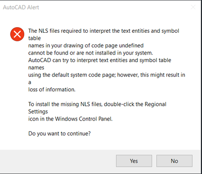

I opened the file you provided and found that first I was missing some information as shown in this image. I have never seen this message before so I am not exactly sure what it is looking for but I suspect that the file was created with a localized version of software (not American English).
I also received a warning that the drawing required Recovery meaning there is some corruption in the data.
