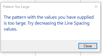

really thanks for kind reply...

That message is from Revit.  While the pattern file is quite suitable for AutoCAD[1] it appears you are trying to take it into Revit where that message is issued on attempting to use Revit's Fill Manager to load patterns containing large offsets.
You can avoid this size issue by installing our HatchKit Add-In for for Revit which loads such large patterns however this may be  a case of perfection being the enemy of the satisfactory.  Unless you are seeking to exactly model 2mm grout you may find a simpler herringbone pattern is   a) visually sufficient  b) lighter weight.

[1] Suitable that is if you can look past the inaccuracies in producing a practical result for 1200x200mm tiles surrounded by 2mm grout as was defined by 8 elements instead of the 360,000 times as many required for a pattern definition containing perfectly orthogonal elements.
