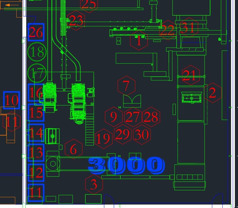

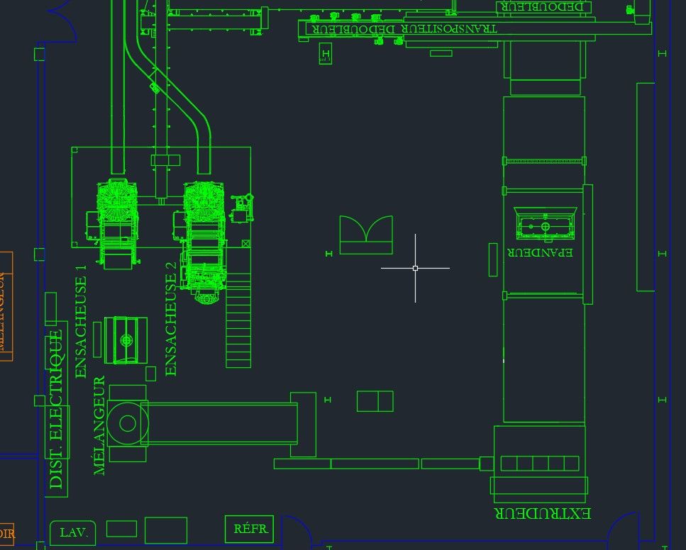

Ok so me again. Tried the Lisp thing. So now i can see the layers in my main drawing. I want the "Panneau PLC, Panneau PU and Panneau PR. Sorry it's in french as i'm in Montréal Quebec!
I did go and put All layers and not Used layers but still.
So this is the layer that i want with all the little stop signs inside the shop. They basically tell you where all the
electric panels are. There are a ton of them in the shop:
And even after the LISP thingy, layers said to be on, i don't see anything in the main drawing:
So i really don't know what else to try or something i'm missing?
Again you guys are awesome. Thanks to all really!

paullimapa
It's possible that those red stop signs are blocks with their own layers which means you'll have to somehow select those layers also.
If you can share a sample of the drawing with those red stop signs then we can take a look.

philippe_heon
Well i did get the 3 layers i wanted and all the blocks in that drawing. Still nothing shows up on the main drawing.
Attached is the file where i want to take the 3 layers and all that's in it.
Panneau PLC
Panneau PU
Panneau PR
Flick them on and off and you'll see what i want to transfer to my main drawing.
Hoping this will help.

paullimapa
so I created this quick wbly.lsp function to select all objects found on those layers and place them in a new drawing attached which does show those red stop signs:
