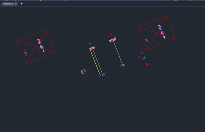

I have a problem copying and pasting objects (not just blocks, everything) in my drawing "R1d16".
Everything is 12X bigger (which is foot to inch scale factor) when I tried to copy from "R1d15". and it doesn't make sense because they are almost the same file, Both files have the same units.
I thought many I changed the scale in R1d16 so, I use Collaborate to check the size, they were the same size.
I've tried "INSUNITSDEFTARGET", "INSUNITSDEFSOURCE" and "INSUNITS"
Can everyone explain what happens, and what System variable changed in my Autocad?

I'm using Civil 3D, but I know some system variables changed in my C3D.
I resisted C3D to default setting and it was fixed.
I wanted to know which variable cause that problem.
