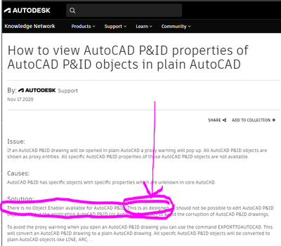

We have received mechanical schematic drawings from a contractor that were created using AutoCAD Civil, P&ID and Plant. When we open these files, we are getting a proxy message that shows all the proxies and which suites of AutoCAD were used. We have attempted using the EXPORTTOAUTOCAD command. For some drawings, the proxy message still appears. However, with less proxies and the message now all shows AutoCAD P&ID and Plant. The proxies from AutoCAD Civil look like they converted to plain AutoCAD. The objects created using P&ID and Plant can't be edited and layers changed in plain AutoCAD. Another issue we are coming across is when running the EXPORTTOAUTOCAD command, some features are not appearing in the new file this command creates.
Another approach we took was to select all objects and explode. However, this presents an issue when attributes are used. Any hidden attributes will then appear. I also looked into object enablers. However, there currently isn’t one for AutoCAD P&ID.

That's how plain AutoCAD works. Your files creator(s) will need to "export to autocad" and send you all new DWG files for your plain AutoCAD software.
OR
1) You are a current subscriber and therefore can freely install and use P&ID / Plant for free to get beyond the issues you listed (and in the interim install and run C3D as a free trial for 30-days to get passed this one single task).
2) you are not a subscriber but you can still download and install as free 30-day trials the variants of AutoCAD you need to do the tasks you need.
How would you like to proceed?
>>>...However, there currently isn’t one for AutoCAD P&ID...<<<
