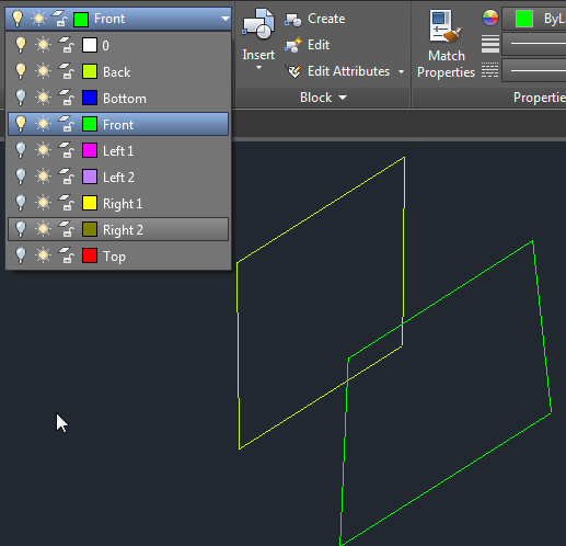

Hi all,
I created a 3D object (dimensions are measured from an existing object) using polylines, and tried to convert it to solid. All lines are joined with no gaps, the planes are not perpendicular.
I tried to make a solid using the loft command using different methods (side to side, top to bottom, front to back, reversing directions, etc., tried it in both Autocad 3D and Inventor), boundary, surfsculpt commands, etc., but the best result I could get has vertical left and right sides, instead of aligning along the sideway diagonal (as in reality) - best seen in top-front or sideways view. I hope the description is clear, the file with the object is attached, thanks for any help.

JDMather
The solution is pretty easy (in AutoCAD or in Inventor), but first thing I would do is set up some layers so you can turn off visibility of certain "wires" in your wireframe to make selection easier.
Back in a while with a solution if someone does not post step-by-step.
(Tip: Forget all the easy sides for now - if you can't do the "hard" sides, you won't be able to solve the problem.)

The first thing I did was set up some color coded layers - while not strictly necessary - I think this helps beginners (and advanced) users.
Then I have an isolation of wires on appropriate layers (Front and Back layers shown).
(set delobj variable to 0 (off))
Isolate the wires for each face of the part.
JDMather
I assume something like this is what you are after.
igor.b05
Thanks, you're the man of the hour!
I've tried many different things and would never thought the solution is so simple. I guess sometimes I don't see the forest for the trees :).
