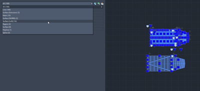

I tried to  use the Flatten command but the area is not the same. How can i do it? Think about a sheet of paper from which I make a cone (3D surface) and then from that cone I want to have the sheet in 2D with the same area of the cone in 3D.
So, I design a boat, and i will attach the DWG drawing. I want that the surface near the boat to be in 2D that i can print like a model.
Can someone do it and tell me how and maybe can record the process. Please!

Your DWG file's content is spread all over the place (about 200-miles away from the 0,0,0 arrow
That alone may not be doing you any favors.
Are these the elements you need to flatten down to a single Z elevation?

I would like to make this in Autocad. as

The bottom gray colored surfaces of the hull are flat and therefore the align command can be used to place them on the XY plane.
The green and yellow surfaces are curved in all directions and therefore cannot be developed into a flat surface without some distortion.  Think of how different projections of the earth are used to show its 3D surface in 2D.
Here's one way you might proceed to create a 2D shape of the yellow surface that has the same area as the 3D surface.
  1.  Determine the area of the yellow surface. Use the thicken command to turn it into a solid.  I set a value of 0.1 and massprop shows a volume of  765.4567.  Therefore the area is about 7655 units sq.
  2. Note that the sides of the shape 1-2, 1-4, and 2-3 are straight. Side 2-3 is parallel to the XY plane.
  3. From the top view create a polyline snapping to the vertices of the surface.  This will create a 2D shape on the XY plane. The area of the polyline is 7014.92...
  4. Since side 3-4 is the only edge that is not straight, it must have a curve to it when the shape is flattened.  We also know that the keep edge 1-4 the same length, vertex 4 must be on the circle centered at 1.  Create a single closed spline (green) as shown below.  An easy way to do this to use osnap endpoint and the CV method for spline as follows:
    click once at #1, click 3 times at #2 (this will create a sharp corner), click 3 times at #3, once at #5, 3 times at #4 and once at #1.
  5. To get the area of the closed spline I found it easiest to hatch and then get then use area object.
  6. Adjust the location of the CV near 5 to get the area you need.
    I got the following for the final shape.

not all, just the second surface, the one below.

Here it is.  To improve the solution select the spline and move the CV at the bottom (#5) then hatch the spline to find the area.  Rinse and repeat until you have the area you want.
