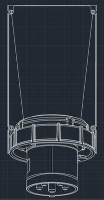

I’m working with an AutoCAD file that contains a 3D component, and I’d like to convert it into a 2D representation. Specifically, I’m looking to generate front, back, and side views of the 3D object in 2D format.
I will upload the original DWG file along with example images to illustrate the kind of output I’m aiming for.
Any guidance or suggestions on how to achieve this would be greatly appreciated. If there’s a recommended workflow or tool within AutoCAD that can help with this, I’d love to hear about it.

depending on your 3d model status ( Solid models only ) you can start with:
  • FLATSHOT (Command). >>>>> For your case the result is " There are no solids or surfaces that can be projected."
  • SOLPROF (Command). >>>>> For your case the result is " No solids selected! "
  • VIEWBASE (Command). >>>> For your case the result is " NA "
You have to convert your 3d model (3d faces) to a solid shape to get what you asked for from AutoCAD.

Unfortunately you don't have a 3DSolid-model, but only a model whose surface is approximated by a lot of triangular faces. That means that you never have e.g a cylinder, but only a polygonal tube.
Attached an example what is the best I can do with such models.
If you need an exact 2D-view of a 3D-model you must rebuild it completely new uing the 3DSolid commands. Only this way you will get 2D views as shown in your first image on the right side.
