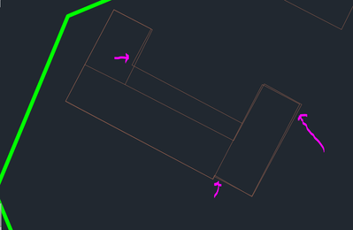

Hello!
I need help with a file I just started. I have this problem with tons of overlapping lines. I tried using OVERKILL and it worked to some extent. It did not solve my problem completely. I tried separating the file as much as I could, but this overlapping is just bugging me and I want to remove. Unfortunately I am unable, so if you can give me any solution I will be most grateful.
I am uploading the file down and once again, thank you in advance.
Sincerely yours, Strahil

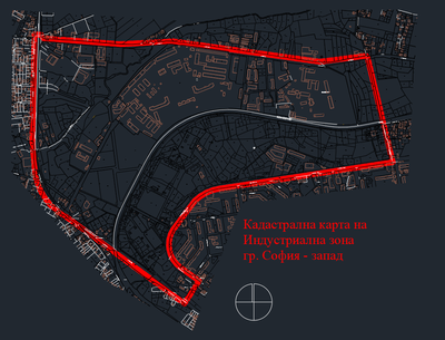

Plain AutoCAD (the topic of this forum) reported 20-errors in it when I used RECOVER command on it, but it also shows that your DGN converted file was sourced from AutoCADMAP3D (or Civil3D): which software are you using please?

Yes, it is hard to find the overlapping line, but also every time I look at some line, and I find that under it, there is/are more line/lines. I can separate the layers to how I want to use them and send it to you. Either way. In every way, there is overlapping in many places.
I also tried using FLATTEN, but it was of no help.
What I have done to the dwg file: I purged a lot of layer. And then I separated the map in 4 groups. If you zoom out, you will see the groups. In green circles I marked places where there is lines which are overlapping each other. I tried the command OVERKILL again, but it did not work. I tried FLATTEN, but also without effect.

@strahil.stefanovv wrote:
...If you zoom out, you will see the groups. In green circles I marked places where there is lines which are overlapping each other....
Fix your file first
remove the MAP/C3D content
Purge your drawing
I used these OVERKILL settings
It found nothing (like you I suspect) because these are not overlapping, just adjacent
Which tells me this setting in OVERKILL needs to be much larger, but then again, too large a number might catch items you want to keep
You basically have a badly drafted/created conversion from Microstation and you'll most likely need to manually fix it in the end.
