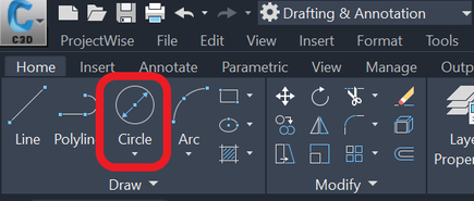

Does anyone know the command/setting to make it so that when making a circle the value written is automatically the diameter, and not the radius?
When working with pipes for water and storm water we never define them by their radius, and only by their diameter, so it would be neat to eliminate one step, since I've numerous times written the diameter and had to go back to change it.
Thanks!

The circle diameter option could work, but it seems like a bother to have to select it each time.
I'm at present using the command Circle (C) and it automatically defines per radius. Even after choosing the Circle, Center, Diameter from the ribbon menu that choice doesn't stay the next time I use the command Circle (C).
Is there something to be done in settings or another command where I can define what I want as my standard?

How I draw a circle:
- Command C
- Click on the screen where the center of the circle should go
- Write the dimensions (which CAD has automatically decided should be radius)
- If I want the diameter at once I need to press down D (diameter) before writing in the dimension
I have tried your written solution in several steps. Between each step I closed down CAD and opened a new model, and tried to draw a circle.
1. Simply moving the <Center, Diameter> above <Center, Radius>
2. Changing the text of the Macro to: "^c^c^p(command "_.circle" pause "_d" pause)
3. Changing the text of the Macro to: "^c^c^p(command "_.circle" pause "_d" pause)(princ)
None make it so that the command C allows you to automatically write the dimension.
Perhaps I need to reboot the whole computer, but that won't happen until tomorrow.
