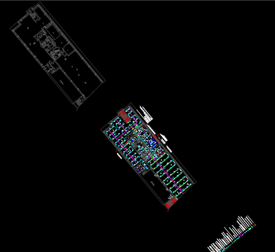

I have 3 autocad drawings, which work fine. When i try to import them into Relux they are rotated and tiny. They seem to be linked to a 0,0 point. How do i remove or change this point.
Drawing attached

This is because your file is rotated in origin . you have to reset your UCS to the way that you wish to insert it in to Relux .see below your World ucs . after that move all of your objects to 0,0 ( if applicable ) . or when inserted to other program specify your base point because your file is already far from 0,0, .

Thaw, On and unlock all layers, rotate the drawing.
