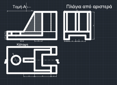

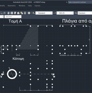

I have been using Autocad for ages (version 2018 for the past 5 year). I have recently upgraded to 2024 and when I load a simple mechanical drawing done in the past, using Autocad 2018, instead of the full drawing I see only big dots and the dimensions set by me, measuting their distances. Could you please help me, because I do not want to go back to version 2018. I attach a snapshot of how the drawing looks like in 2024 and how it supposed to look like (version 2018 and free onine viewers).

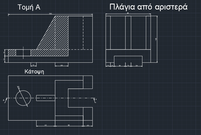

Just to make sure, I have installed Autocad 2018 again and got a screen shot from the original file. I attach it here. As you can see, Autocad 2018 sees that file just fine. Same type (Autocad) but version 2024 cannot. None of the products is Mech.
Any ideas?
Thanks again,
Panagis

I tried clean-installing Autocad again, but I get exactly the same behavior from Autocad: missing lines and big dots. Did you try opening my dwg file in your system?

Indeed, and I cannot add any more guidance than what was already provided by @Valentin_CAD in several posts. There is no display issue here with your DWG file in R2023 nor R2024 with our without LWDISPLAY on
You need an IT fix/drivers/display/new computer perhaps.
