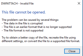

I have a DWF/DWFX file that i want to import into AutoCAD 2016 and then later convert to a .step file.
When using the command DWFATTACH command and choosing the file i get the following problem (See pictures below). Anyone have any ideas?
I can open the file and see the 3D-model in Autodesk Design Review 2013, but i cant export it to STEP in that software.

Hi @fredrik.tallroth.91,
I see that you are visiting as a new member to the AutoCAD forum. Welcome to the Autodesk Community!
Can you share the file so I can take a peek at it?  In the mean time, try printing it to PDF to see if that will let you attach to your host file.
I was able to view the DWFx in DesignReview also but similarly I was unable to attach it to a DWG.
I tried a few third-party converters and they too ended up with empty files so this indicates to me that the file actually does have some corruption and is not likely workable in AutoCAD.
If you have specific views you could print those to PDF from DesignReview.

Alfred.NESWADBA
>> I have a DWF/DWFX file that i want to import into AutoCAD 2016 [...]
Just to add this information about "Why does DWFATTACH not work with that file" ==> DWFATTACH can only handle 2D DWF files (created with _PLOT or _PUBLISH), not 3D ones (created with commands _EXPORT or _3DDWF).
