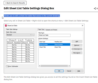

Message 10 of 10
kittyLB3XQ
I tried that as well but it only works as a new table. 😭 When I try to pull in the sheet set list from SSM, even referencing the updated table style, it still comes in with the headers. Is there a setting I'm missing in the sheet set manager?
