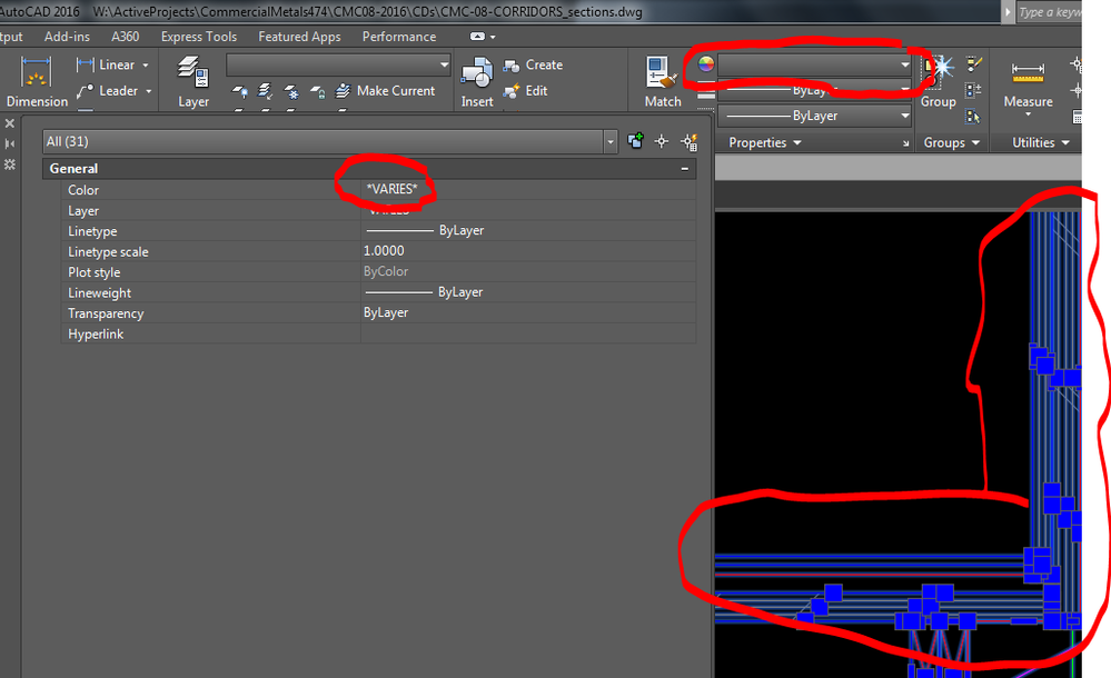

Lemme show you what I mean:
In the accompanying image, the lines towards the left side that are cyan are on a layer whose color is set to green. At the top it says color is ByLayer, but that's obviously not true.

On a side note, I just ran a test: I changed a line to be Blue, then selected all objects. The color tab in the Properties panel still said "ByLayer", but when I opened the the Properties palette, it said *VARIES*

Otherwise... when all objects are set to BYLAYER, the color entry only shows bylayer when you select them all, even if they are different colors. See below.
When the objects are NOT set to Bylayer, those entries are blank. I'm using one of my files in this screenshot to lessen your confusion
