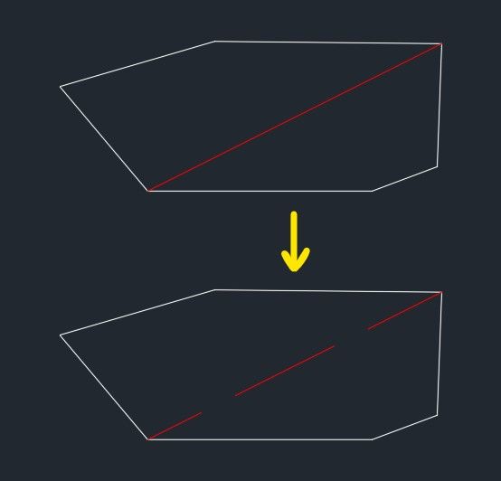

matinmaleki222
In an easy explanation It's about making a continuous line to dashed line with 2 mm gap space.
But the important part is I can't and i shouldn't use line type or custom line type.
Just break a lot of number of lines to 2,3,4 or even more segment base on their length.
There is no intersection object or any relationship just making 2mm gap on simple multiple lines based on their length.
In the picture attached, there is a red line for example that i want that to be broke with 2mm gap. in a full DWG there is 500 or even more of this line. i want a way to select all red lines and make them broken with that gap.

Message 19 of 25
Kent1Cooper
It's unfortunate that your breakdown of lengths vs. number of segments is not a regular progression.  Some are 50mm ranges, some 100mm, there's no length range to divide into 6 segments, etc.
Would it be acceptable [it would certainly be far easier to encode] to have it break all selected Lines [and even other things like Circles/Arcs/Polylines/Ellipses/Splines, if you like] into however many segments it takes so that there are 2mm gaps between them and each segment is no longer than 50mm?  I have code that would provide a starting point for such a routine, in the DIV+ command in DivideMeasurePlus.lsp, >here<.  It will place Points or Blocks or marker Lines at whatever quantity is needed so that the spacing doesn't exceed a specified maximum distance.  It should be relatively easy to modify that to Break instead of drawing something.
Kent Cooper, AIA
