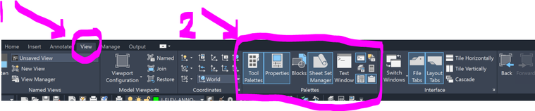

pendean
Community Legend
Community Legend
Also in the Ribbon...
