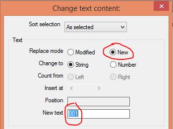

3wood
You can also try attached ALTEXT.vlx.
Complete the task in 3 steps.
You need load ALTEXT first.
Step 1,
Select a target block, then select all similar blocks by using "Select similar" option in the shortcut menu when you right-click the block.
Step 2,
Use command ALTEXT to change certain attribute value to "001" or whatever is the first number.
Type in attribute sequence number.
Change certain attribute value to a start number.
Step 2,
Use ALTEXT again, select "p" for previous selection. Change settings as below:
The result is as below:
You can also sort the number order with a certain rule, just simply select an option from the first pop-up menu.
