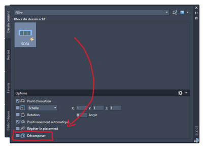

You have this original bloc (the on overlayed in green by the COUNT command). That's a bloc
Those other overlayed in red ARE NOT BLOCS anymore. At least that what I can tell from these screenshots.
Do you remember how you inserted those reds one in your drawing ? If you did trought the BLOCSKPALLETTE commande , make sure that in the option tab at the botom of the block's pallette window, the ''Exploded'' option is unchecked.
