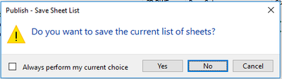

Although not new to Autocad, I am new to batch plotting. I have ac 2016 and know the basics of setting up a batch plot. I want to print to pdf a bunch of layouts from different drawings. I am able to add sheets to the list and there is a green check mark beside each one, However, when I hit the button to publish I am getting this popup warning:
"One or more drawings have unsaved changes autocad, save the file so a dsd file can be created"

Did you try SAVEALL command before you started PUBLISH command?

You can print an unsaved file if you don't create a .dsd. file. The .dsd file is created when you choose Yes to save the current list of sheets in the Batch Print/Publish command. Only save the sheet list if you want to plot the same files, with the same layouts exactly the same way more than once.
When the Publish - Save Sheet List dialog opens choose No to not save a .dsd file. If you will never use .dsd files highlight No then check the box Always perform my current choice and hit Enter. You can turn it back on from Options, System tab, Hidden Message Settings.
