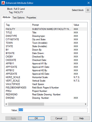

Currently my best guess is this block but no idea which tag:
And which page setup name:

In this case, the Block Title actually contains the DWG size information (i.e. "Full D Land") ... its not in one of the Tag IDs in the block.
This Page Setup would be "PDF-DL-NU"
Likewise, DWGs with Block "Full C Land" would be "PDF-CL-NU"
