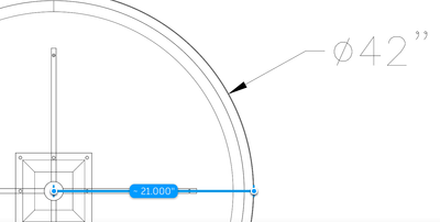

For instance, the furniture in the drawings are blocks and consist of solids. Without exploding the block, the viewers cannot readily obtain the geometric information in a useful way.
Of course on a simple round top, a straight dimension will give you a radius. This will not work on the elliptical solid of the longer conference table.
Since this collection of blocks is in 3D I suspect that even AutoCAD LT will not suffice as it is really intended to work with 2D information.
Now I did try Fusion 360 with your file and it does handle all the geometry quite well so that might be a consideration if the cost is low enough for you. You might grab a a free 30-day trial to see if it does what you are seeking.
