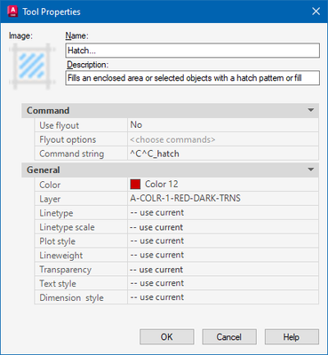

I want a tool that when clicked, is going to hatch something with a preset hatch pattern, layer, color, and the selection method is Select Object with Pick Points as an option.
For the life of me I can't get that. I have everything I want currently, but it defaults to ONLY pick points with no option to select.
If I use the Hatch command as the tool, I don't get any options for the pattern - it just uses the current pattern (the last one used).
I could create my own command, (which I've done before) just curious if I'm missing something obvious.
HATCH Command that defaults to Select Object but offers Pick Points on the command line:
Or my Hatch tool that I can set everything, but it ONLY looks to Pick Point (no option to Select Object)

You forgot to use all the tools available for your personal custom macro in first screenshot:
HPNAME system Variable before you launch that hatch command.
^C^C_HPNAME;SOLID;_HATCH
Explore all the other HP* variables in HELP to make that macro do way more if you so choose:

I think you got it covered all right. You can't change the hatch tool, you can't assign a pattern to the command macro... well you can but it's just a menu macro with all its limitations... so if you know how, make your own LISP command. At least that's what I would do.

Or you can use a little lisp as a macro to get the best from both worlds. Set the common properties by a tool options, your 1st img.
^C^C^Q((lambda ( / p) (setq p (getvar 'hpname)) (setvar 'hpname "SOLID") (initcommandversion) (command-s "_.hatch") (setvar 'hpname p)))
