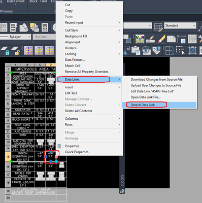

cadffm
Activate the table edit mode, select all (looks like that)
Contextmenu ->
Sebastian
Message 6 of 10
paullimapa
FYI, if you want to permanently remove the datalink to the excel file:
Select any one cell inside the green marked area
Right mouse click & select Data Links on the cursor menu
Left mouse click on Detach Data Link
On the popup window select Yes
Now you can insert rows above & below any row
Paul Li
IT Specialist
@The Office
Message 7 of 10

john.uhden
@cadffm ,
"Verbindung Aufheben" translates to unconnect or unlink, which did not appear in the English menu.  So I tried the third item from the bottom of the menu, which is "unmerge."
That did not solve the problem, but I seriously appreciate your effort.   Many thanks!
John F. Uhden
Message 10 of 10
cadffm
I tried to show the same as Paul posted later in #6,
but for the whole table/all cells
and today I can create a screenhsot from an english version 🙂
Sebastian
