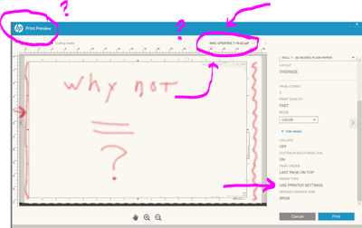

Why does Autocad crash every single time when hiding frames of jpegs and pdf's in paperspace?
When I enter fields in the attribute editor the fields sometimes don't populate, why?
I select show frames but don't plot and it's still plotting frames even with PDF and JPEG frames set to 2 using the keyboard commands, why?
Setting paper space to size D using a 36" roll of plotting paper with extents, size to fit, and center selected there's a large margin on the right hand side of the print. Why? What does center print even do if it isn't centering it for prints?

4) your plotter/printer or driver determine margins, never you: especially if you don't have the option of an "Oversized D" sheet option for minimal margins. The placement "center" has nothing to do with margins, sorry.
Can you describe what placement center does and how to center margins please?

Located a post from 2001 about printing margins not being equal and some workarounds but why hasn't this problem been addressed by the software developers?
As far as the application crashing when trying to hide frames in paperspace why would that be user error?
It would be nice if center plot actually centered the plot according to the paper roll size selected according to the sized print requested. What does that feature do anyways? Does it work as intended? Users are currently required to use an "old school" workaround and implement their own margins while using a modern printer and the latest version of autocad from what I have found. Would it be difficult for software developers to make a feature that will allow users to center plots that are 2" smaller then the paper roll being used?

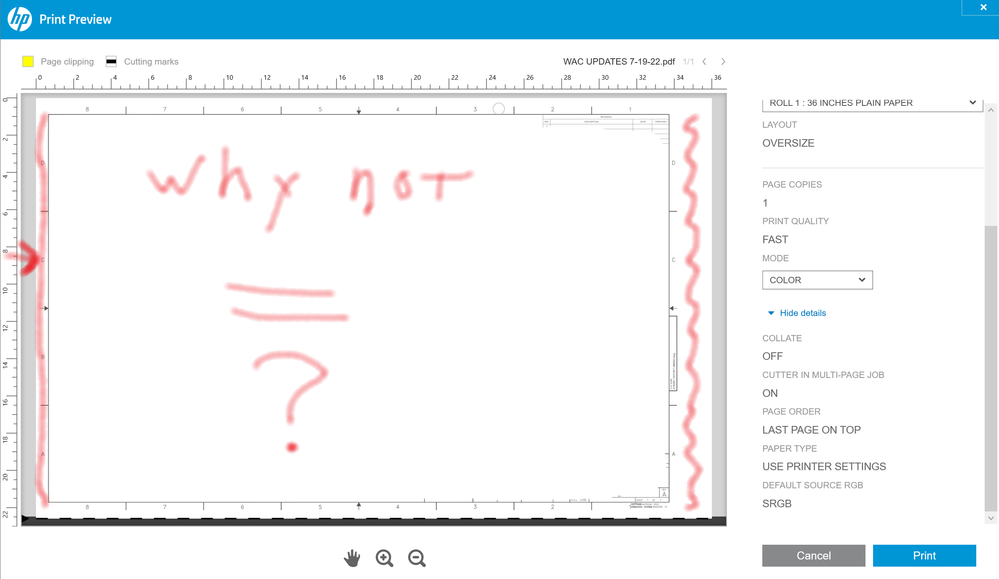

     I appreciate the time and consideration to help resolve these problems occurring. While reaching out to HP I'm told there is no way to currently adjust the printing area on the paper roll print out using their software which is interesting. Additionally there has been an update to AutoCAD since I made this post which has been installed but I have not checked to see if the crashes are still occurring or if the batch plot pdf will show frames on images. The images where embedded with copy paste.
     After creating a new document with nothing on it and attempting to plot from pdf as well as directly from autocad it has generated the exact same result with a 2" margin on the right side of the plot, I've also tried plot window as well as plot layout instead of plot extents doing this which has the same results. It must be some sort of default nesting protocol to start the print on the left and print towards the right with no way to adjust it using HP software. So far the best solution I have come across is to account for the margin while generating the document leaving a 1" gap on the left side of the paperspace, but I have concerns that it might throw off the scaling of the end plot if not done correctly. Essentially what the workaround seems to be currently is to change the entire page setup to a 36" sheet instead of a 34" sheet for the ANSI D size the end user requests, which is problematic for several reasons including scaling I think. It might be better to trim off the extra margin but didn't think it would be such a process to center the plot onto the paper sheet being printed on. Does anyone know a better workaround for this issue occurring to prevent needing to trim copious plots off the plotter?

 I don' know about your model, but our model HPT930 lets you control many choices here (each saved as a PC3 file for AutoCAD users) so we all don't end up being slaves to default settings set by someone else at HP
