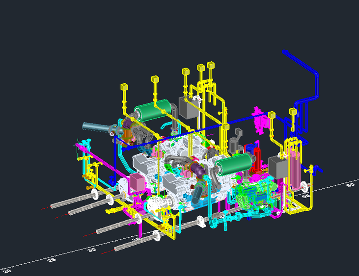

I'm not sure what have I do before, but is there any way to make the object become brighter? I have checked the visual style, color layer, lighting, sun, and anything that is related to light but the color still looks different. Original.PNGAfter (darker).PNG

All the layer is unlocked. I have tried lock and unlock again but it still looks dark.

Hi Valentin, only some of the object are XREF, but I also tried to adjust the value but all the object still looks dark.

Thank you for all the support, but it still looks dark. I have attached a google drive link here. I would be happy if anyone can solve it. Thank you.

Change your SHADEMODE setting to anything other than SHADED
