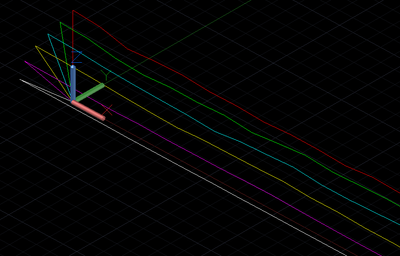

As a proof of concept I used Excel to create polylines in AutoCAD for the first six profiles (the profiles with Y values of 0 through 5).   Since the planes of profiles have constant Y value we want to enter x,z data with the elevation used to define the plane.
The Excel concatenate command was used to create comma delimited values for x and y from the x and z values of your data.
The elevation was first set to a value of -Y (minus Y) followed by the pasting of the x,y (actually x,z) values for the polyline.  The elevation was then set to the next -Y value and the data for that polyline pasted into the pline command.  The process was repeated until there were 6 profiles.   Rotate3d, all   about 0,0,0 (WCS) by -90° yields contours in planes parallel to the XZ plane.  The profiles are colored below to help in visualizing the data.
The loft command was then used to create a surface.  Here 's the surface with one isoline in u and v.

Since there are over 500 vertices for each profile I would consider creating solids for groups of profiles (e.g., 6 to 10) and then union the resulting solids into one solid if necessary.

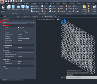

leeminardi's way of drawing the corroded plate is easy, but I want it to be drawn like this...
The model consists of multiple 3D Solids with uneven surfaces.

I want it to be drawn like this one, wherein the mesh was drawn one by one so that they will be of equal sizes
