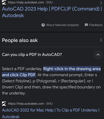

How to clip out the white after creating clipping boundary? Where to click?
Message 8 of 8
tboehler
Use the PDFCLIP command.
