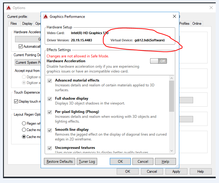

Have you received any fix for your situation? I too have have the same issue and tried all that you have as well.

john.vellek
Hi @smattie,
Can you describe your workstation? What is your operating system and specific hardware? Also which version of AutoCAD and what service packs and hot fixes have been applied?

smattie
​Surface Book; NVIDIA GeForce GPU; i7
Windows 10​
AutoCAD 2016 SP1
No hot fix

john.vellek
Hi @smattie,
Which specific nVidia card do you have and which driver? If you have this problem and have confirmed that you are not in SAFEMODE in AutoCAD, I suggest we consider rolling back drivers to the oldest version we can find. If that works we can step through more current drivers. In your Graphics Performance window, what is the Driver Version and Virtual Device values?

smattie
SAFEMODE = 0
The nVidia card is the optional "discrete GPU" (Graphics Performance staes
"NVIDIA GeForce GPU")
The driver version is 10.18.13.6472
virtual device: gdi12.hdi
Yes - i'd be glad to install a trial

Safe mode in AutoCAD does NOT mean the same thing as in Windows "Safe Mode"
Are you starting AutoCAD with a command line switch to disable hardware acceleration ?
Like this:   "C:\Program Files\Autodesk\AutoCAD 2016\acad.exe" /product ACAD /language "en-US" /nohardware
If so AutoCAD will not let you switch back to hardware acceleration enabled within the software
The word "Safe Mode" should be changed to "Hardware Disabled on startup"

smattie
Oh, I thought you meant safe mode for AutoCAD - no, I never run Windows in
safe mode.
The error I get is "Changes are not allowed in Safe Mode" - I am not
running in safe mode.
I'm not sure I understand your note:
"Like this: "C:\Program Files\Autodesk\AutoCAD 2016\acad.exe" /product
ACAD /language "en-US" /nohardware"
"The word "Safe Mode" should be changed to "Hardware Disabled on startup"

john.vellek
Hi @smattie,
Internal sources tell me that the Surface Book is not actually a supported configuration for AutoCAD. I have not found the specific article regarding this yet but I did find one post that might be worth exploring for your issue.
"Since I can't enable hardware acceleration for the Nvidia chip,   I found out that by disabling the Nvidia chip and forcing Revit 2016/2017 to use IntelHD520,  Revit lets me use hardware acceleration and it works faster than Nvidias GPU in software emulation mode.
In AutoCAD there's a huge difference."
Many Surface Book users have issues with the display card in AutoCAD and Revit and some of it has to do with resolution but it appears that the issue you have is a typical condition.  Please try the above process and update your post so others might benefit.

smattie
Once the NVIDIA GeForce GPU is disabled, the Intel 520 video card permits hardware acceleration. Interestingly, the Graphics and Performance window still shows the NVIDIA GeForce card being used. though has been clearly disabled.

Hello All,
We have AutoCAD 2015 on Windows 10 64 bit OS i7 processor 16 GB RAM HP lap with Direct X 12 installed. It has 2 graphic cards Intel and NVIDIA Quadro M3000M and I have update both drivers. I have tried with /nohardware, /safemode and nosafemode in start up properties but no use.
I have disabled NVIDIA driver and check also even I can not turn ON Hardware acceleration.
Please refer attached image and help to solve the issue.
Thanks in advance.
