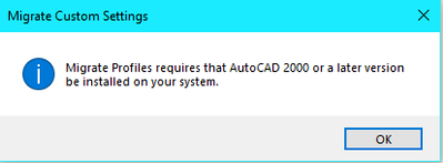

john.burnison
Sorry, now I'm more confused.
When trying to run "C:\Program Files\Autodesk\AutoCAD 2023\AdMigrator.exe" the next message appears
0 Me gusta
paullimapa
did you include the entire command including the reset parameter:
"C:\Program Files\Autodesk\AutoCAD 2023\AdMigrator.exe" /reset /product ACAD /language "en-US"

john.burnison
Thank you... but it did not fix the issue...
It did reset all my settings, but the issue still persists.
