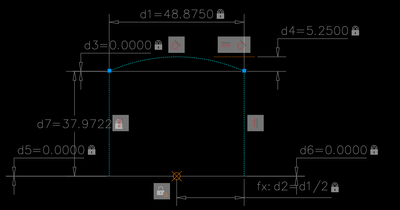

In this dwg I have a lot of different arcs with radii that all have a consistent offset with each other (total offset is 3.875).  What I'm trying to do is set it up so that I can change the width (47.875) and/or exterior curve height (5.25) of all the arcs at the same time, without decoupling the center point of each arc, or causing the offset between each arc to change.
I've tried to use dynamic blocks, but I can't figure out how to make that work without the radii getting messed up, and I can't figure out how to set parametrics up to make it work either.  Any help or pointing in the right direction would be appreciated.

leeminardi
Here's an example of using parametric constraints. Change either d1 (48.865) or d4 (5.25) and the geometry should update as I think you want.  Note that I have added a fixed reference point to aid in maintaining symmetry.

jogibson6PA7C
This is the basis of what I've been trying to figure out.  The sticking point that I'm running in to is making it so that changing the parametric variables for that one arc will automatically change the layout of all the other arcs in the set.
When I do have parametric constraints set up for a single arc, my next step then is to add in linear parametrics to lock the shape of the arcs together, but i always get a bunch of really strange results from that.  I've tried aligned as well, but the issue there is it distorts the geometry where the arcs meets the straight lines.

jogibson6PA7C
Edit:  Through whatever object of serendipity I'm experiencing right now,  adding the concentric restraint to the setup I have in 1.02 actually worked this time.  Usually, when I add the concentric restraint, it makes everything break even worse. Pairing that with your original 1.01 then allows me to do *exactly* what I've been trying to do which means your 1.01 setup was the missing piece.
