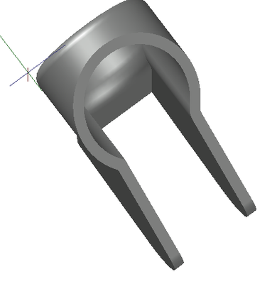

I am trying to create the Cater drawing from training session in Youtube.
https://www.youtube.com/watch?v=MVYVIJrGBy0.
On minute 3:43 they instruct to use Shell command,
As SOLIDEDIT Select a  3D Solid, select solid object, Click Add, Click Remove. Then I Click on three surfaces, next step
Remove faces or [Undo Add All] - I click enter.
Next step SOLIDEDIT Enter the shell offset distance - I enter either 1/8" or 1/4"
Next step SOLIDEDIT [Impront seParate solids Shell clean Check Undo Exit] <eXit>
I click enter twice -Nothing happens.
Please, advise
I have included actual file I use for your reference.

When i do a section of your solid in your dwg it looks like its already been shelled. Do you have an earlier version of your dwg before you shelled it?

Thank you very much for your quick response.
I was able to resolve this issue.
