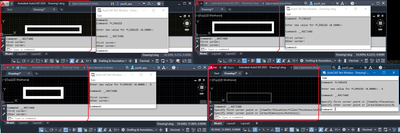

paullimapa
so I finally got a chance to go through AutoCAD 2020, 2021, 2022 & 2023.
Only AutoCAD 2023's RECTANG comand has additional options.
But from AutoCAD 2020 through 2022, the RECTANG command depends on PLINWID to set the global width:
Paul Li
IT Specialist
@The Office

cadffm
@paullimapa
all your pre2023 version shows NOT the native rectangle command!
I see, you tried to force the native command by üusing the period,
but only your 2023 picture shows the usual acting and the usual command prompts.
Is it the same in -2022 version if you start Acad in /safemode ?
Sebastian

Kent1Cooper
My 2020 has those options:
and the same if I do it with the period prefix .RECTANG.

Message 16 of 23
paullimapa
Looks like my 2020 Rectang mystery command continues.  But of course we all missed it now looking back at OPs screen capture  tittle bar showing AutoCAD Architecture 2019
