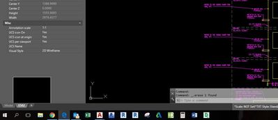

2018-0212 AutoCAD Freezes while trying to change the layer of Viewport.  This is a dwg with 3 layout tabs.  This is a simple 2D lines and text drawing with a few blocks of Fire Alarm symbols.  I had turned the layouttabs=1 because I needed to create the paperspace tabs.  Whole window is now unresponsive, I can't even minimize it. Total Time Lost = 30 mins.
Message 6 of 32
Alfred.NESWADBA
Can you please upload that drawing so we can test it on our systems?
