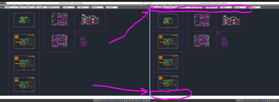

I had a drawing with a few empty layers that couldn't be purged so I copied all the elements, opened a new acadiso.dwt and pasted (to original coordinates) which solved the issue. Now, when using Zoom>Extents with a new file it does not zoom out completely, while it's working fine in a "bloated" file. In layout tab everything works fine. I'm super curious what could be the issue? I'm attaching screenshots.

To confirm, this small amount of space is of concern/topic of your post, nothing else, correct?
Message 3 of 13
babicdusko
Correct, it's not much but I'm quite curious what might be the issue. As you can see in the third photo, everything works fine in the layout tab.

Here are both files. The one with "copy" suffix is having the issue. Strangely, before attaching files here I opened both, tried once again and to my surprise the copy was working completely fine. I reopened the "copy" and the mentioned issue was there again, so there's something wrong and erroneous with it. Thanks

cadffm
EDITED:
The issue is your current view setting: Command _VIEW
look at camera point and compare with other files.
Nothing to do with the content, nothing to do with you copy&paste,
The problem comes with copy&paste of your ROTATED images!
Looks like a bug in the program.
Change rotation to 0 and it works without that issue.
check the source of the "new file" you used, perhaps the issue was there before you pasted
or you did something to change it after your pasting!?
(sorry, no time to explain to reset the view setting, search for it or wait for another helper if you can't solve it)

You got it. I can see camera and target coordinates are off and original drawing had a roll angle but I haven't figured out how to reset it - seems I'll have to work on building my knowledge in the camera/views/plan area. Do you have and good resources to recommend? I copied elements to a new drawing and everything works fine though. Thanks a lot!
