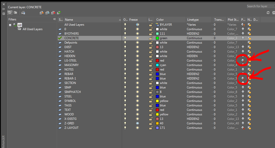

I am having the same problem since up grading to 2017. Please see the attached files.
The LG-STEEL layer was randomly turned off and I did not notice it until plotting to pdf.
Message 6 of 17
Here are some more .dwg files with the issue.
The LG-STEEL layer again (seems to be this layer often)
As well as the Rebar-1 layer (also seems to repeat in other files)
Please let me know what you find.
The only layer that should be non-plot is the Z-Layout layer.

You have those layers set to noplot
Message 8 of 17
Exactly, but what I am saying is that I did not change them to non plot, somehow there were changed after upgrading to 2017. Before that they were set to plot.
