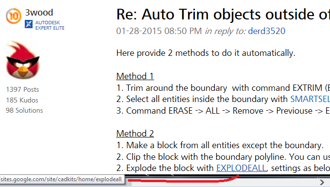

Here provide 2 methods to do it automatically.
Method 1
1. Trim around the boundary  with command EXTRIM (Express Tools)
2. Select all entities inside the boundary with SMARTSEL, then press Esc to cancel the selection.
3. Command ERASE -> ALL -> Remove -> Previouse -> Enter.
Method 2
1. Make a block from all entities except the boundary.
2. Clip the block with the boundary polyline. You can use CLIPIT command.
2. Explode the block with EXPLODEALL, settings as below:

Why doesnt "EXPLODEALL" command doesnt work in my 2016 version of auto cad inspite of having a 3 year licence?
You do know that this is not an AutoCAD command, it's a tool that has to be loaded.

could u tell me how to  load this tool?
Follow the link 3wood provided in method 2.

I am surprised that extrim in Method 1 didn't work.
If Extrim doesn't work - then for the add-in in Method 2, click on the hyperlink.
