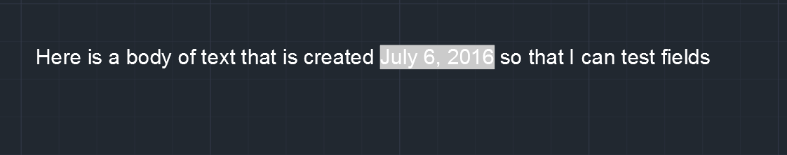

john.vellek
Hi @mikeevans6697,
I am wondering if you could use Fields in your MTEXT to do some of what you are looking for?
I have attached a sample drawing with Mtext and an inserted Field in it.

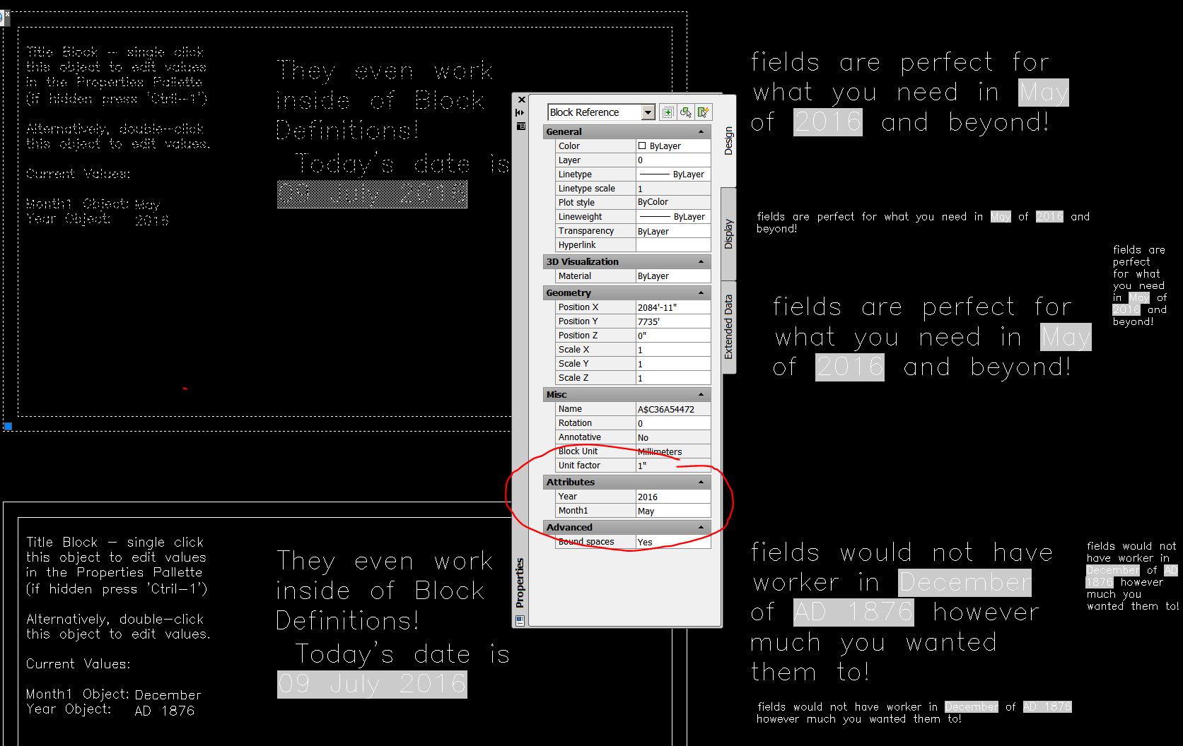

john.vellek
Hi @mikeevans6697,
I did play with your sample file.  I tried setting the mtext embedded field to read a block attribute and it seemed to work well until I added visibility states to the block that the attribute was part of.
So, my conclusion is that it does allow for spacing in MTExt and such but it isn't any faster than using an attribute or simply typing the value in as mtext itself. The advantage though is if you are using it more than one time on a sheet. For instance if you used the survey number in both the description,  on a map, and possibly in a titleblock then the fields could all read the value entered just once into an attribute.
So for the sample you sent me, I decided it was actually better to but the districts in their own visibility states and to share the survey number.  I have attached a file for you to play with. I hope this helps a bit for your process.

CADmonkey_UK_Building_Services
acad forum fields.JPGTitle Block - single click this object to edit values in the Properties Palette (if hidden press 'Ctril-1')
Alternatively, double-click this object to edit values in a dialog box.
