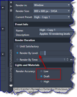

Just one additional info: using render accuracy "low" or "draft" with a bit higher number of render passes also creates better images and faster (in most cases).
